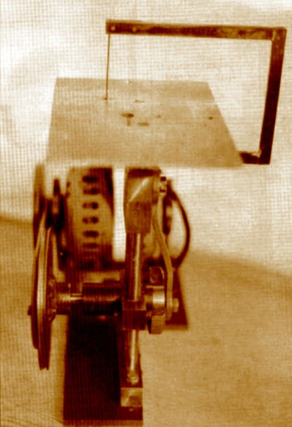

There is one big caution with this design – in filing mode the end of the file extends above the machine and could pose a mjaor hazard to your eyes if you lean forward over it, equally in jigsaw mode the blade is exposed . There are 101 ways to fit a guards to this machine, I suggest copying Stan Bray’s approach of a piece of tube held over the end of the file or sawblade by an arm attached securely to the body of the machine with. Please don’t operate this machine without such a guard, or without the simple wooden box guards for the lower part of the machine that are described in the article.

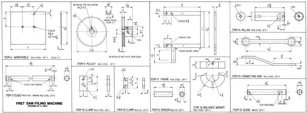

Download side 1 of the plan as a PDF
Download side 2 of the plan as a PDF
