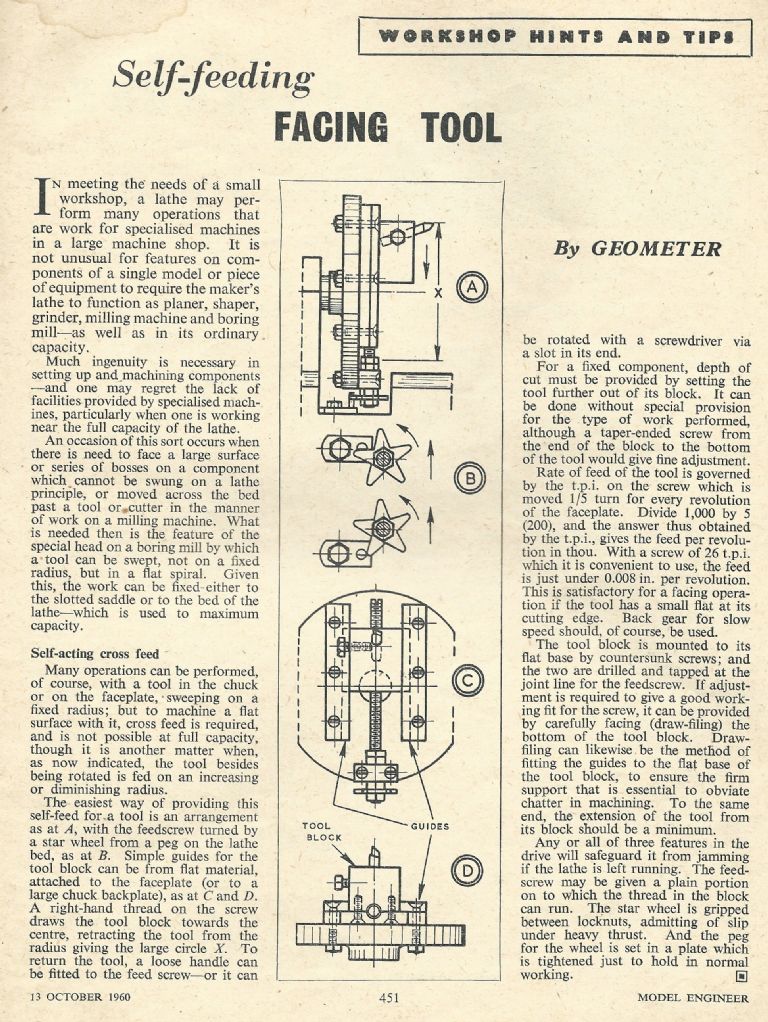

This design is by 'Geometer' a nom-de-plume of Ian Bradley. It first appeared in Model Engineer Volume 123, Issue 3092, 13 October 1960.
You may also download the article as a pdf here
