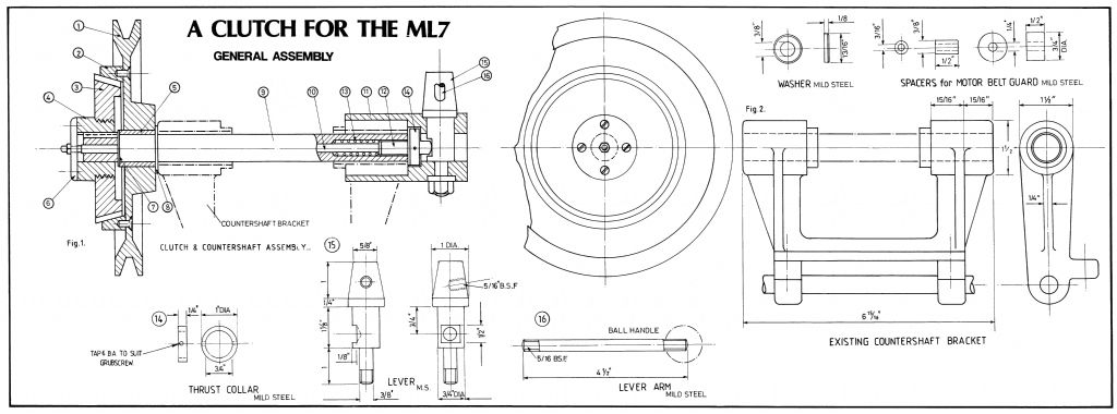

Free Plan: A Clutch for the ML7 Lathe
by
Like so many of these plans we hope it will be of interest to all and of real use to some who may well find this a very useful and practiocal modification, one which could be apllied to any lathe with a countershaft of this type.

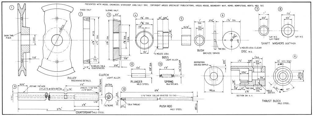

As usual, the full size plan is contained in these two lowres jpeg files and full detail accompanying pdf versions, lower down the page are individual pages that can be printed on A4 sheets and taped together.
