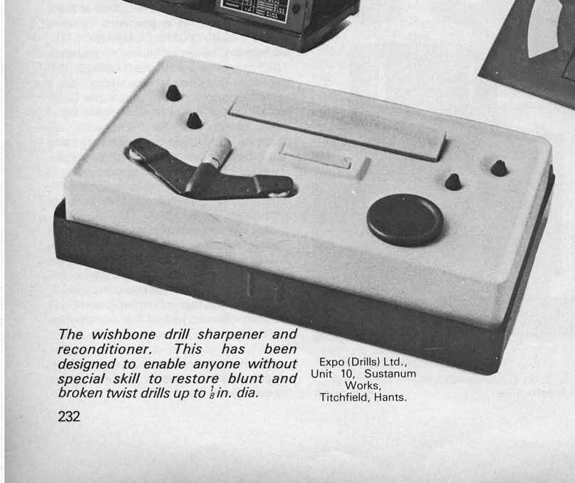

                        NJH
                          @njh
                          Hi
                          "…… a jig for sharpening small sizes e.g. #42 to #80. "
                          Is this device the " Wishbone Drill Sharpener" ?
                          If so I think I have details somewhere.
                          Regards
                          Norman

                                        #110580
                                        Sub Mandrel
                                          @submandrel
                                          The 'wishbone' concept is simple. The wheels at each side align a drill clamped or chucked in the middle at 118 degrees one way or the other. You then pull it back across a stone, gently leaning it to the right to give a little relief.
                                          #110583
                                          Dennis R
                                            @dennisr
                                            Found a picture of a "wishbone" sharpening kit in Model Mechanics May 1979
                                            Dennis
                                            #110586
